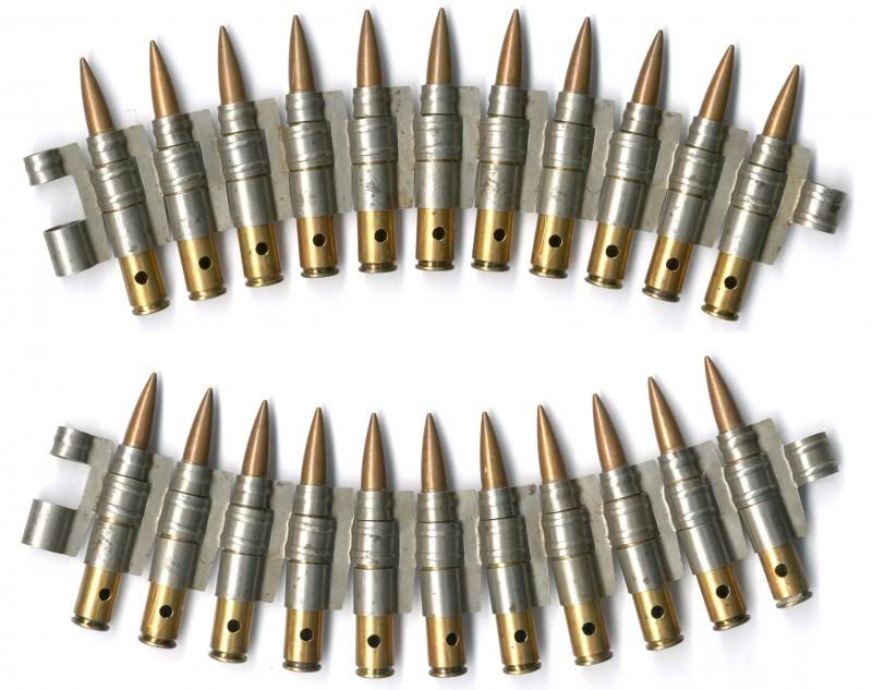

7,9 l.S. in Prideaux Vickers aircraft type links
I have three 7,9 German l.S. in Prideaux Vickers aircraft type links that seem to be original by fit and patina. I am not aware of the configuration of such ammo in these links. There are no visible markings on the links under 10X magnification.

Hello,
this is a piece of belt for Czechs mod. 30 aircraft Maxim in caliber 7.92x57.
During WW2 these weapons were reused by the Germans for ground use, mostly for anti-aircraft duty.
The pre-WW2 Czechs links are uncoated plain steel with a typical white metal outlook. Wartime production is characterized by the matt grey-green phosphate finish as also seen on MG34/42 50-round belts.
Accordingly your belt is wartime production (nice piece by the way ! )

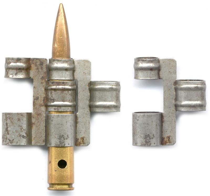

The first mod. 30 Czech Maxim was intended for aircraft fixed mount. Therefore, the first links for that configuration was based on the original WW1 Prideaux design with square corners and permitting almost no fanwise and helicoidal flexibility. These first links are bare steel.
1st model of Czechs links for fixed mounted Maxim mod. 30 :

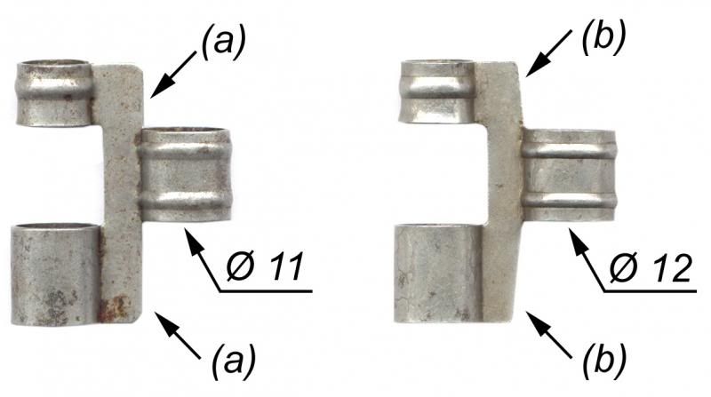

When the weapon was adapted for aircraft flexible turret mount, it was required that a new link be designed in order to increase both fanwise and helicoidal flexibility. Therefore the links were modified by increasing the internal diameter of the single loop (from 11 to 12mm) and chamfering the top and bottom connecting wings (b).
Here is the comparison of 1st model (left) and 2nd model (right) :
