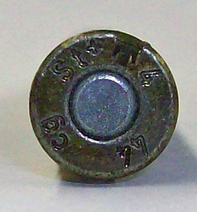

EOD your case appears to have a very interesting squared rim. Can you post a HS?
Will do soon, hopefully this weekend.
The hs did not look special (well I am not the measure in all this).

Hi Rolf,
Honestly, I have thought the same thing. Have you seen any other fake pt rounds?
No, not in 8x33. The problem is that a very good fake is hard to identify and I always like to say that every collector has a fake in his collection.
I think this round should go to the fake collection of Bill Woodin.
Rolf
[quote=“dvollmer”]Thanks Dutch.
EOD your case appears to have a very interesting squared rim. Can you post a HS?[/quote]
Ok, I added the hs above.
[quote=“EOD”][quote=“dvollmer”]Thanks Dutch.
Ok, I added the hs above.[/quote]
@ EOD, You were too fast.
Took a wile to find the case with your head stamp.
Sorry :)
