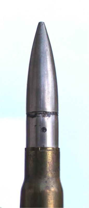

Often, especially on 7.92mm contracts they used their generic commercial headstamp “KYNOCH 7.9 or 8m/m” with some modification to denote load. This example of a tracer has a red annulus and “G” overstamped at nine and three o’clock. Examples of this style are also known with “W” for AP and “B” for smoke tracer incendiary.
Tracer1_zpse419f795.jpg~original
Sometimes the commercial headstamp was used simply with an annulus colour. This example has a blue annulus and when the bullet is pulled the weep hole of the phosphorous smoke tracer incebdiary bullet can be clearly seen.
