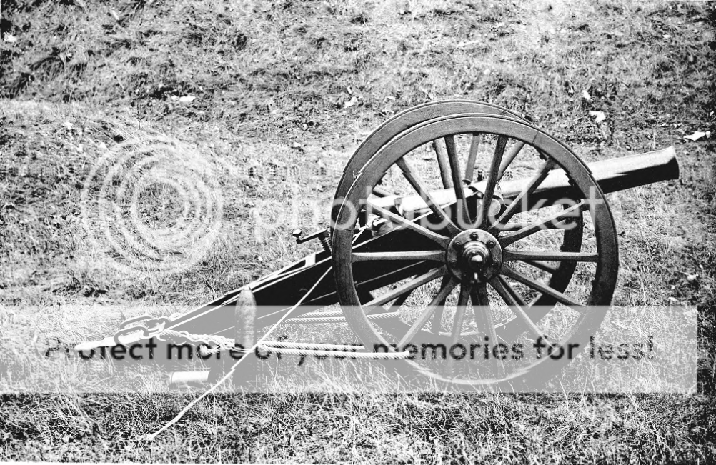

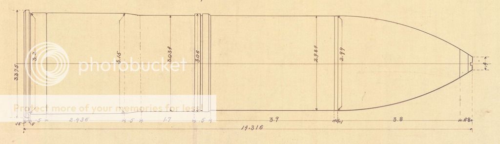

Below is a picture of the gun and a drawing of the round loaded with a common shell. The case is of the Hotchkiss separated ignition type (primerless), which means it has a vent pierced through the head that is filled with musket powder and sealed with wax. Ignition is produced by means of an external friction primer and aided by five eccentric holes surrounding the vent that lead to the propelling charge.
Fede
Note: There is a mistake in this drawing, since the groove between rim and head actually measures 0.05" (0.15+0.05+0.5+2.436+.5+1.7 = 5.336"/135.53 mm).
