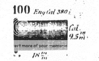

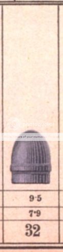

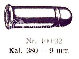

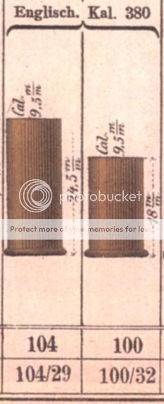

Regarding its designation, it seems that G. Roth considered that 9.5 mm was the equivalent to .380 from the 1880’s until c. WWI, and later changed to 9 mm. In the following excerpts you the see the designations used in 1886, c. 1910 and 1927, respectively.
Fede
1_zps5sig1rm61a_zpsv15veaag
2_zpshzqo1aaf3_zpskfatrkfy
4_zpsfjf1v3sj
Thanks Fede, and everyone.
The evidence of evolution in the caliber from Roth’s own catalogues seems to fully support it being simply an early version.
