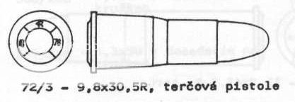

Orange, dimensions of the Dreyse pistol chamber cast are also very close to the 9,8 x 30,5 R M. B. Scheiben-Pistolen (GR 72).

Pascal, GR 72 looks very similar to your cartridge -except case lenght-, but reported body & neck lenght dimensions from specimens are not alike (these are very difficult to establish). I would like to see a picture of a confirmed GR 72 case (published drawings show a very short shoulder).
Fede, here’s a pic with three different shoulder positions and or shapes but all very close. The id on the cartridges are with a certain reservation. I do not have a GR72 with Roth number in the headstamp (if there even is one known). Wanted to put a GR199 in the picture but cannot find it for now.
Best, Pascal
Just noticed headstamp scans are from right to left.
Pascal
Pascal, thanks for the pictures. With the information known it seems that your unknown round could be a cut-down GR 72 case. This has a more pronounced shoulder, however.
