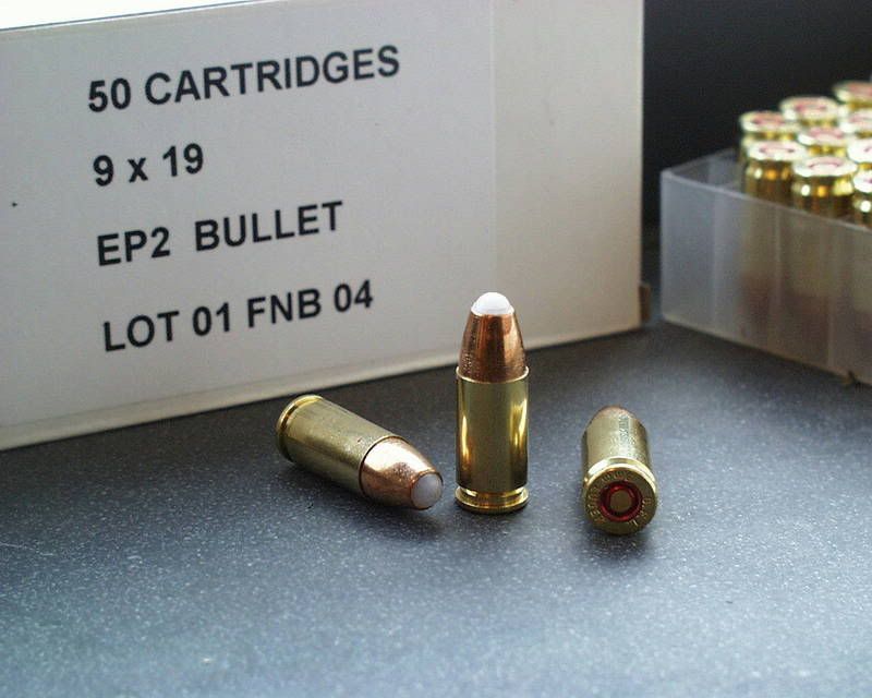

Here some new photos box, headstamp, EO-number and page of brochure.
Richard

I think the Winchester monobloc may be part of an ongoing effort by FN. The 2002 Winchester effort for FN was followed by the EP2 round for FN that was manufactured by GFL in 2004. Note that the steel ball in the Winchester round was replaced by a plastic ball.
I don’t know where this EP2 effort went, but the rounds are hard to find and I have not seen anything that looks like a follow-on.
