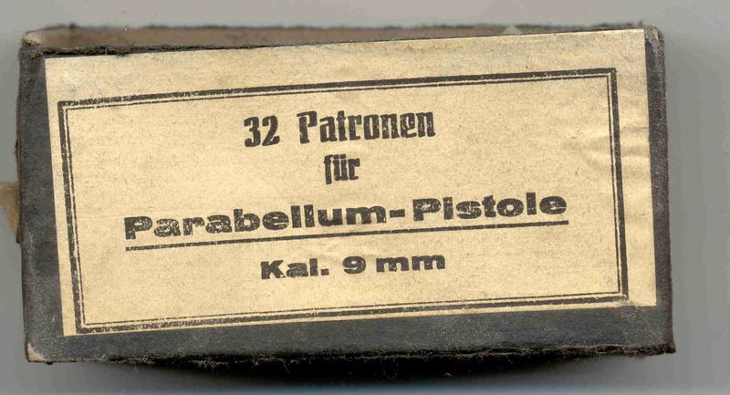

Thanks to Lew for correcting me on these. I thought I’d show the box, label and contents in this separate thread.
The bullets on the unmarked rounds are magnetic, while the ones with the P 24 head stamp are not.
So this appears to be a repackaged and relabeled box from that era, containing both FN made and Solothurn made examples, or at least with components of both manufacturers.

Vlim,
Thanks for the great box photos. They are very similar to other German repack boxes I have documented. The P 24 rounds all have FN headstamps, and the non-magnetic bullets would be FN also. The primers are however either Solothurn or Polte, so these would be loads probably done by Polte using mostly FN components. FN loaded rounds would have a domed primer. It would be interesting to know what powder is in them. If it is grayish tube powder it is also either German or Swiss.
Thanks for the box label. German boxes usually, almost always have P 24 loads with mixed components like this one.
Unheadstamped German rounds are not uncommon. I have a number of WWI style boxes with blank labels and unheadstamped loads. I suspect they are post WWI from factories that did not want to be identified. There are also DWM commercial, and Spanish label boxes with unheadstamped rounds. Are the unheadstamped rounds CNCS or GMCS bullets???

Note that the typewriter label shown by Vlim uses the non-military “9 mm Parabellum” name , not the military “Pist. Patr. 08”

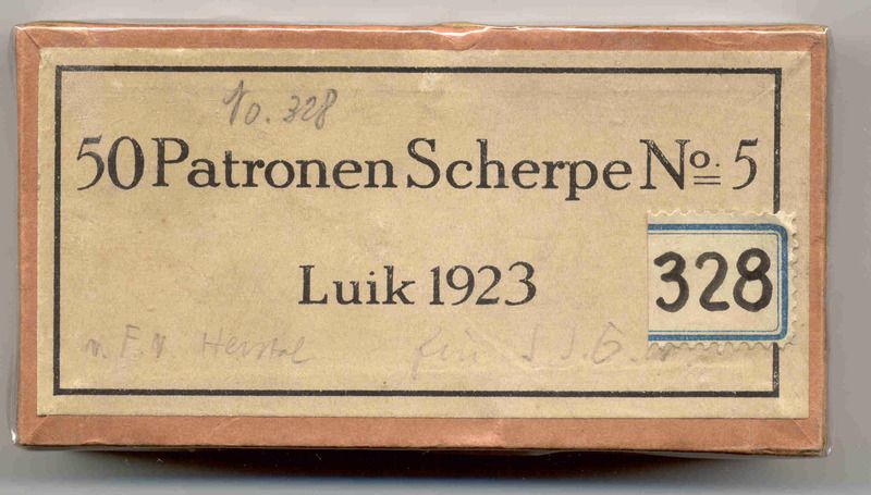

After the article was published, I obtained the box below. It was found in the Thun storage area and came to me directly from Thun. It is intriguing for a number of reasons.
First, it is a typical box for the Dutch Vickers Luger, but from 1923, when the only known FN production was in 1922. FN may have bid on this contract in 1923, but they clearly did not win the Dutch 1923 contract which was awarded to Kynoch. This box was likely produced for the bid sample of ammunition submitted in 1923 and not used.
Second, the box was filled with the typical Belgium loads with non-magnetic CN bullets, Belgium cases (short 4) and domed primers with a black pa.
Third, the front of the box had written in pencil “v. F.N. Herstal fur J.J.G.” and JJG was the initials of the chief inspector (QC) at Thun in 1924. The two “328” entries are the Swiss identification number for the 9mm Para.
Fourth, it makes clear that FN, not CB produced this style P 24 ammunition. It also pretty well confirms what was suspected for some time, that FN was the producer of the CB 9mmP ammunition.
Finally, this also clarifies a point on the contracts, clearly FN was a subcontractor to Solothurn for the production of this ammunition.

A number of different style Generic boxes similar to the one Vlim pictured have turned up with P 24 rounds mixed in.
The likely sequence of events was when the direction was sent out canceling the orders, some assets at both Solothurn and FN may have been used for other requirements. I suspect that Solothurn took possession of the residual assets when they settled with FN on the cancellation. They may have loaded some for other reasons, but I suspect that when the Prussian government settled with Solothurn they received the residual assets including the left over components. Attachment 3 shows the variety of boxes the P 24 rounds show up in. They all appear to be German except for the Swiss box below. The rounds in the German boxes always have the flat primer-probably German primers, with a mixture of Swiss and Belgian cases and bullets.

Some Readers might wonder what “Luik” on the label means. Belgium is a 3 language country (the King has to give his oath in Dutch/French/German): Luik/Liege/Lüttich are 3 names of the same city, which is often taken as the location of FN, although FN really is in Herstal on the outskirts of Luik. This explains the pecilled FN Herstal on a Luik label.
JPeelen: Thank you; I did wonder what Luik was, but rejected any of the twelve months pretty quickly! Many European place names in languages other than the local one are fairly obvious, but some are really tricky. Jack
JPeelen, Thanks for the correction and explanation. I forget that people may have a question on “Luik”.
