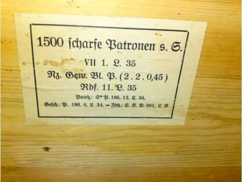

Some other boxes with the district code.
District/ Wehrkreis:
I - Königsberg
II - ???
III - Jüterbog
IV - Zeithain/Riesa
V - Kassel from 1935 IX
VII - Inglostadt
451kr.
451kr – thanks for showing the labels. The 1500 round label VII 1. L. 35 is another 1st time seen for me. I’ve seen the 15 round label before but not the 1500 round.
