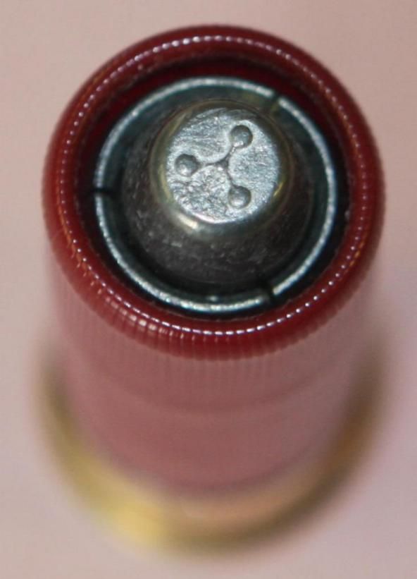

On my .45acp “lethal” version, the Kevlar tethers were gummed up into the nose plug so hard that I didn’t dare tear them apart, and I assume the force of being shot would probably unwind these and obliterate the silicone nose plug. The lethal version has a red silicone nose plug, and the semi-lethal version is yellow. The brass is all commercial so the headstamps are nothing new. I did like how the 12ga slugs have the company logo cast into the tip of the central slug though.

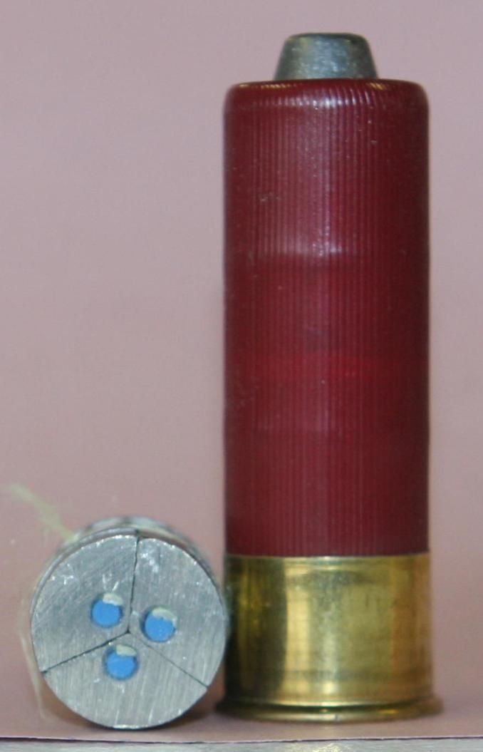

Here is the 12ga “stopper”. the 3 projectile sections which fit together weighed 200.5gr, 202gr, and 205.5gr. The central slug weighed 120gr and the whole payload weighed 734gr including the Kevlar tether in the core. Note the blue plugs at the base which is something used to anchor the Kevlar tethers:

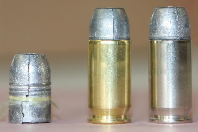

A few days ago I received from a collector 2 specimens of the .45acp Multi-Impact load which was entirely different from everything I had previously seen. The projectile was still divided into thirds, but the ogive was different, and there was a lead ball in the nose cavity instead of a colored silicone plug. The brass was the same I have previously seen on their “semi-lethal” version, being Top Brass brand.
Version I already had at left, newly received version at right:
P92500082_zps7cd6ffe0
The total projectile payload weight is 143.5gr, and shares the same petal design, and construction method of seeming to have the Kevlar tethers cast into the base of each segment. The lead ball is loose, but held in place so long as the band of Kevlar around the three segments is not removed. I was told that this was perceived to be a “4th generation” version from Advanced Ballistic Concepts, according to the collector’s source, but I have only ever noticed 2 versions including this one. I first purchased some of this ammo back in November of 2013 when it was first released, and then again I purchased more in March of 2014, both times it was the previously described variation from earlier in this thread.
I presume the presence of the lead ball is for two reasons; to improve feeding in auto-pistols, and to avoid the issue of the inner tethers becoming stuck in the silicone as I had found on one projectile I had dissected previously. This lead ball turns the payload into a quadruplex, technically speaking.
