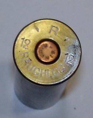

Another German shotgun shell
Here is another German made shell and I’ve been able to research a little about it. I know it was made by GECO, likely in Durlach, Germany prior to WWII but what interest me the most is that the cup is steel, as is the primer. They both react very strongly to a magnet. The case is paper and it has a roll crimp with a pink topwad (3 1/2 mm) Can anyone educate me on why and when this steel cupped shell was made?

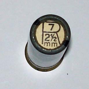

Top wads - little summary from IAA forum
Hi Shotmeister.
Here are some more of the same type!
As you can see the top wads correspond with the headstamps.
To your question, WHY STEEL?
These are wartime production shotshells, They used the steel for shotshells so the brass could be used for military rounds.
I know of RWS Normal cases also but never found one myself.
Regards rené
Thank you Rene’. I thought they might be wartime production but wasn’t at all certain.

René, this 1939 production has a brass plated steel base.
It was made for the German air force.

René, the letters that I’m aware are A (unknown), D (G.G.&Co. Durlach), E (unknown), R (Rottweil) and W (Walsrode). These are all Luftwaffe contract cartridges for the Sauer & Sohn M. 30 drilling (12-70/9.3x74R).
Edit: Sorry, these are not for the drilling but clay shooting cartridges for the “Doppelflinte der Luftwaffe”. Also, the drilling was 12-65/9.3x74R.
