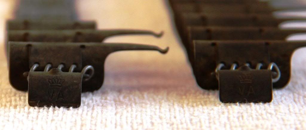

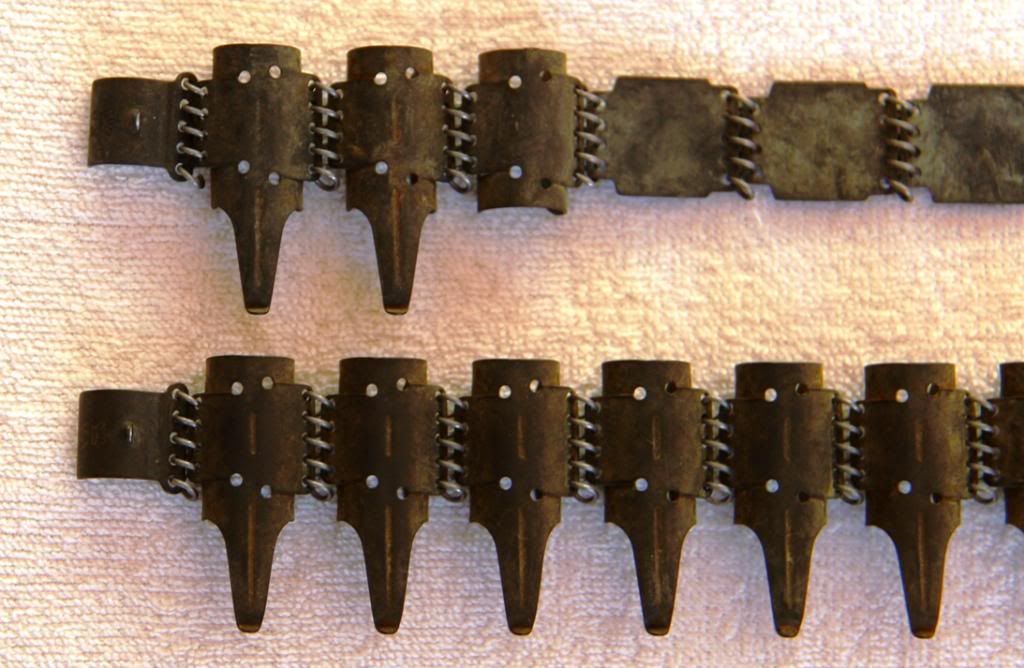

The semi-circular connectors of the belts and the starter tab are similar to the German Gurt 34 (for 7.92x57 machineguns):
And marked with ‘(crown)VA’:

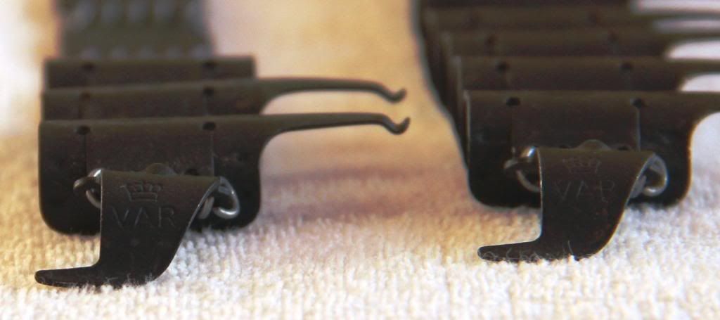

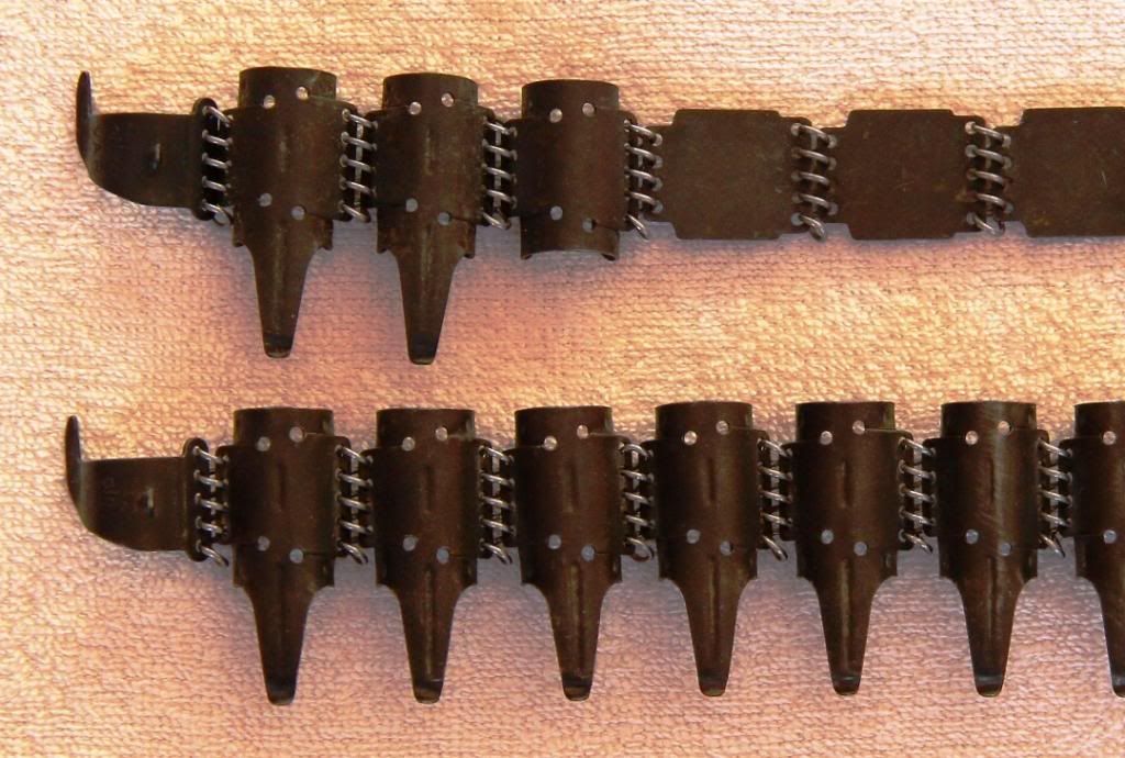

For comparison: The modern versions have ‘noses’ on the different shaped connectors (identical to the belt ‘DM1’ for the MG3 of the German Federal Army):
They are marked ‘(crown)VAR’:
The Danish Let Maskingevær M/62 is similar to the German MG3 (a modified MG42 in 7.62x51). I believe that the newer belts with the ‘noses’ have been accepted together with the MG in 1962. However, I do not know which Danish designation the newer belts got. Maybe ‘patronbånd M/62’?
