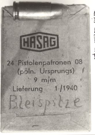

One thing this Forum does is remind me how little I know about 9x19mm ammunition. We knew that SFM produced 9mmP before WWII because there is a box of soft-point cartridges with by SFM with a German “HASAG” over label dated 1/1940. This appeared in the ECRA Bullatin in the mid-1970s.This was the earliest French 9mmP cartridge I had documented. The box itself is 24 rounds and shaped like a typical Polish box of the period.

Below is a photo of the SFM Soft Point cartridge and the Polish/German box they came in. I mentioned this box in my post above.
