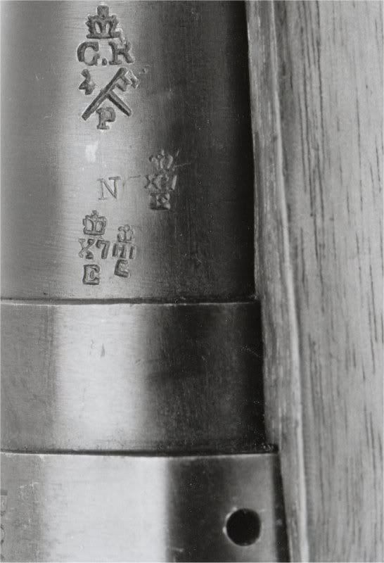

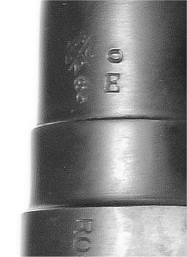

This is not quite the full story. Although there were problems with some British ammo with regard to gauging, particularly that from Birmingham Metals and Munitions, the real problem lay with the manufacture of the Ross rifle.
The original Ross Mark III rifles were chambered with a head diameter of .460" (and some were found to be .458") which was lower that the British low limit of .462". Canadian ammunition was also manufactured to this lower tolerance. Quite how the Canadians came to manufacture rifles and thd ammunition that were different from the Imperial standard is not known.
Another problem was that Ross gauged the chambers before assembly and not after breeching up. If the barrels were torqued too tightly in the receivers this compressed the chambers even further.
When this was discovered in 1915 the chambers were reamed to .462" and the chambers stamped with an “N”. This was done from 9th July to 15th August 1915 when the chamber was again changed to .464". Rifles with the larger chamber were stamped with an “E” for enlarged chamber.
The rifles that had come to the UK with the CEF still had the smaller chamber so Lt.Col. Harkom (an ex-Enfield apprentice) was sent from canada to the UK to sort matters out. He set up the Canadian Ordnance Depot at Ashford in Kent and reamed the chambers to .464", stamping them with “LC” for Large Chamber, not Long Chamber.
He also hardened the bolts and bolt stops, but that is another story.
Pictures show the three different chamber stamps.
