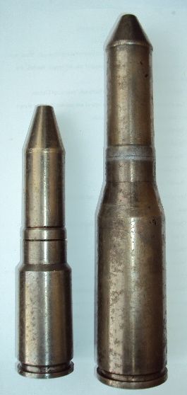

I decided that I needed to preserve the 2 x Stalpatrone because as you can see in the first pictures there are many spots of rust showing through the ‘blueing’ . Twenty years ago on advice from one of the best Imperial War Museums restorers I started using a conservation liquid called BIOX. This removes rust, tarnish and verdigris, but has no effect on existing paintwork or other markings. As it says on the bottle it is ‘A biological corrosion remover which is completely harmless to man containing no strong acids or alkalis. Designed for the treatment of iron, steel, copper, brass and aluminum’ . I have used it successfully on many items over the years with nothing but good results. I placed the two Stalpatrone in a bath of BIOX and left them to soak for about 30 minutes. On my return I was horrified to discover that the ‘blueing’, if that is what it was, had simply vanished leaving the steel and the rust spots. As it was too late to salvage the rounds in the condition they went into the BIOX I left them until the rust had also been removed.
A lesson indeed as I normally try and preserve any specimens I have in the condition I receive them.
I attach a picture to show the rounds now.
Ian, can you show pictures of the base and tip of these cartridges?
Fede, as requested, as I am sure you know the 34mm has a solid tip to the projectile.
Ian, thanks a lot for the pictures. The base cavity of the 30 mm round doesn’t correspond to the drawing of the Stahlpatrone 212 given that its outside diameter should be about 13.5-14 mm. Also, the shape of the nose cavity doesn’t looks correct for this cartridge.
It is not my intention to offend you with my opinion, but I can’t find no reason to believe that these are original German cartridges, or manufacturing variations of the same. If these were made for Birtish tests or they are simply collectors’ replicas I don’t know for sure, but due to lack of documentation I’ll keep with this last possibility.
Fede, Thank you very much for all your input. Freddy Mead had some wonderful items in his collection including a MK III .303 which sadly I could not afford to buy. I never thought that the ‘Stalpatrone’ were anything but genuine, but it looks as if this is not the case. I wish Freddy was around now to explain where they came from and maybe why they were made. Sadly now I don’t think we will never know their history or that of the wooden dummy. Still they are nice items to keep. Ian
