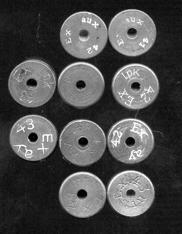

The same change from serif letters to no-serifs occured on the red plastic Ex cartridges in 1943. Both “ay” and “lpk” rounds occur in 42 and 43 with serifs and in 43 without while “nts” occurs both with and without in 43 dates and without in 44 and 45.

Below are the headstamps on red plastic dummies in my collection. I have documented an nts Ex 43 without serifs but don’t have an example in my collection. The three producers of these rounds who were producing in 1943 converted from serif letters to non-serf letters during that year. All production before 1943 used serif letters and all production afterwards was non-serif letters. The probability of all three just deciding to use serif letters, and all three deciding during 1943 to convert to non-serifs seems remote to me.
My small sample of 7.92 red and black plastics is composed of only 40, 41 and 42 dates except for one ay from 43. Serifs are used on all the aux, ay and lpk rounds, but dnb and byw did not use serifs on their headsamps. No help here to find a pattern in 1943.
