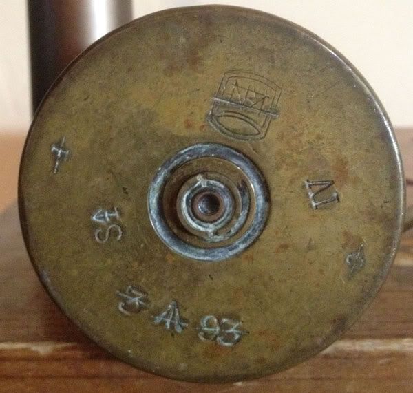

I’m hoping someone can ID the cannon case shown below. Its dimensions are (to the nearest mm):
Diameter at case mouth: 65mm
Diameter above rim: 68mm
Diameter of rim: 76mm
Case length: 249mm
Headstamp:
12 o’clock: KN in cylinder
2 o’clock: IV
3 o’clock: C
6 o’clock: 3 ^ 93 (^ is a British broad arrow)
8 o’clock: S followed by a spear-like symbol
9 o’clock: F
All markings except the ones at 2 o’clock and 8 o’clock are struck through with horizontal lines, so presumably this has been reloaded at some point.
Additionally, there are two rectangular notches cut through the case about 12mm below the mouth, spaced 180 degrees apart. Here is a side photo of the round next to a 30mm GAU-8 for scale, as well as a photo of the headstamp (sorry for the poor-quality images!).
Am I correct in assuming that KN indicate King’s Norton Metal Company?
The KN inside a drum is indeed the trade mark of Kings Norton. This case has traveled about a bit as the “S” followed by an arrow above an “I” is an Indian Ordnance mark.
gravelbelly
This is a British 6 Pounder Hotrchkiss Mark 4 case. It was made by Kings Norton Metal Co. in Abbey wood, Kent UK. It was then loaded with a full charge of cordite in March 1893. this is indicated by the “F” stamp.
It was fired once, then reloaded at an arsenal in the Southern circuit of India as a blank. The “SI” with the arrow stands for Southern Circuit. The loading date and “F” would have been crossed out or “cancelled” when it was reloaded.
When these cases were reloaded as blanks, they were shortened to the length that your case is now, and the slots were added to hold a fibre board cap. The case would have originally been 307mm long with a neck to hold a 57mm projectile.
That is a nice find with an interesting history. There probably aren’t many of them in the USA.
Thank you both for the great information. If only it could tell its story - I’d be very interested in how it ended up in Arizona!
