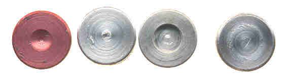

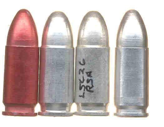

I have wondered it this was by Kobus du Plessis who also makes the Impala bullets (I’m told). I have two confirmed dummies by Kobus (the two in the middle below) which have a different bullet ogive. The Kobus with the very small primer cavity is apparently a very early dummy and most production had the much bigger cavity. The unknown dummy (on the far right) has no cavity for a firing pin. More significant perhaps is that the unknown dummy has a significantly different bullet ogive from the two Kobus dummies. The groove dimensions and the treatment of the casemouth are also different.
On the far left is a red anodized aluminum South African dummy reportedly made by Thor Engineering. The unknown dummy seems to be closer in shape to the Thor dummy, but the extractor groove is still somewhat different.
Clearly the unknown could be by Kobus, but it is not obvious.
