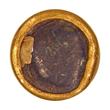

The more I learn the more questions I have. I have been researching the Perrin revolver and cartridge and learned the LeMatt revolver started as a percussion later chambered for pinfire then center fire for the Perrin round. The LeMatt revolver is unique in that the cylinder rotates on a smooth boar barrel. There is a shot cartridge pictured in Brandt’s “Manual of Pistol and Revolver Cartridges” #175B 12mm LeMatt. I have what may be one of these. The dimensions are as follows:
One piece case length = 44.76mm /1.770”
Sharp corners on rim, dia. = 13.44mm / .531”
Base dia. = 11.88mm / .467”
Mouth dia. = 11.78mm / .462”
Case has battery cup primer with back to back GG logo @ 12:00 and CANNE 12 @ 6:00 impressed.
There is a rolled crimp with brownish top wad.
Question is Canne an old spelling of cane or Canne France?
Question is this the 12mm LeMatt round?

We’re missing an image here. This was provide to me as a 11mm or 12mm LeMatt revolver shot cartridge.
If it’s not, then I’d like to know what it is!
Thanks
Overall length: 1.275" (32.42mm)
Mouth diameter: 0.455" (11.54mm)
Rim diameter: 0.520" (13.23mm)
