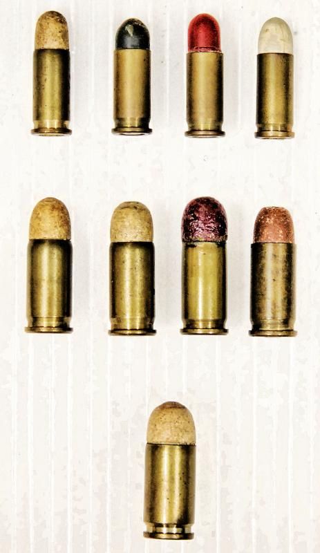

Belgianbulletedblanks-perhapsMarga_zps5beaaf98
Bulleted-Blank cartridges, all in FN cases with one exception, noted below. There are variations in my collection of some of these types, but the projectiles are the same - they vary only in headstamp lettering and primer cup shape and material.
Top Row, 6.35 mm Browning, left to right: Marga type with plain wood bullet, as also show in entry by Lew Curtis with the box label; Black wax-like bullet (could be plastic - difficult to tell); Red bullet that appears to be plastic, although it could be hard wax as well; white paper bullet. This round is unheadstamped, with six large, square, equidistant primer crimps that take up a large portion of the head. It was supplied to me as being Belgian, and as there are many unheadstamped Belgian rounds, without documentation such as a box label, that cannot be disputed.
Middle Row, 7.65 mm Browning, left to right: Marga plain wood bullet blank, second one probably the same, but with different bullet ogive; wood bullet colored red; last one has a composite bullet, or so it appears, a brownish red color.
Bottom Row, 9 mm Browning Short Caliber: Marga plain wood bullet blank.
Missing from the Marga blanks with plain wood bullets is the 9 mm Browning Long, which is the only other auto pistol caliber I, personally, have seen from Marga.
Collection and Photo by John Moss
