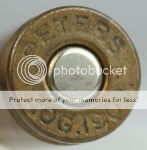

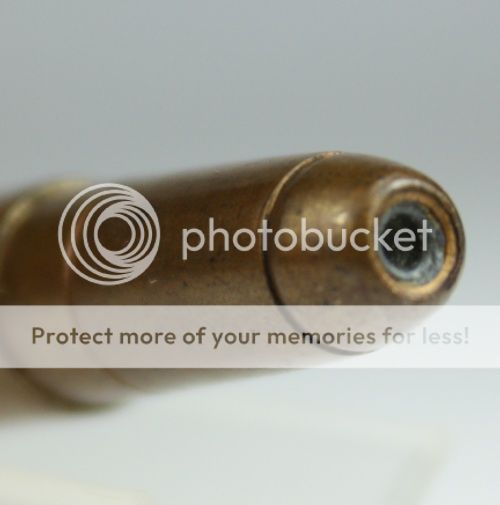

Missing the lid, a factory sample set.
The close-up sectioned piece does not have a tinned ‘belt’. Sorry but the close up is cropped from the other which I sized & set the dpi before I cropped it. Still you can see the inner piece. Somewhat different than Ray’s quality sectioned example in that the outer jacket incloses the inner ‘belt’.
Headstamp is; PETERS 30G1906

Nice sample box. Very interesting the different construction seen between your example and Ray’s section work. It sure looks like Ray’s item has a “belt” with a consistent wall thickness and the thickness of yours seems to vary with its interior following the outer contour of the main jacket. I note that Ray removed the core on his example though I can’t think how that would matter regarding the “belt” unless heat was used and something with a low melt point once resided there…

The sectioned piece in my set is not tinned, and the inner ‘belt’ is fully enclosed within the outer GM jacket. Where on Ray’s example the inner ‘belt’ extends above the outer jacket to form the bullet tip / nose.
A better photo, to clear thing up a bit.

Thanks for showing the clearer photo. That is indeed a different design from what I thought I was seeing in the earlier pics and pardon me for misunderstanding your description. Without the distinct tip from the inner jacket, would guess that to be the later “Inner-Belted Hollow Point” design as Ray earlier suggested. Catalogs do show the “Inner-Belted” and “Belted” designs co-existed in 1940 and 1941 listings.
That design was later simplified as the well known Core-Lokt (on the right in the photo).
