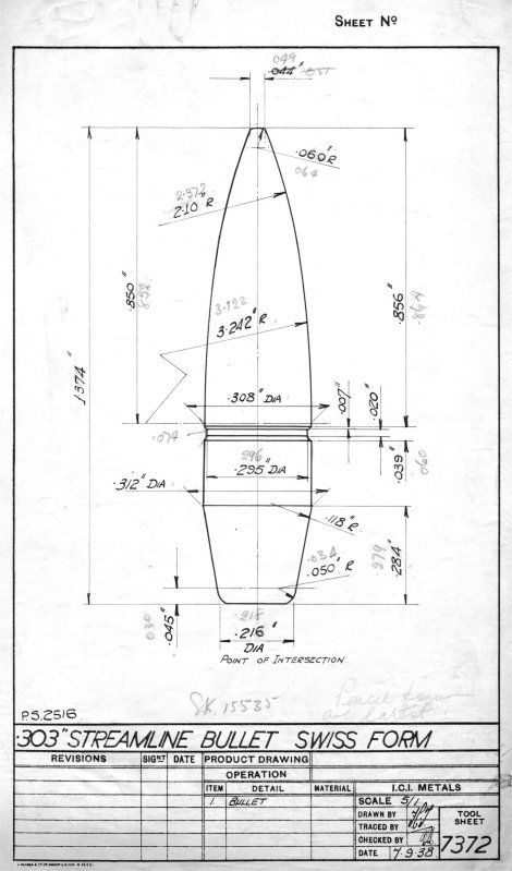

Kynoch’s first streamlined .303 match bullet was in 1924 and attached is the drawing for the virtualy identical 1925 bullet.
The Small Arms Committee later bought a lot of this match ammunition to develop the Mark VIIIZ bullet and also attached is a 1937 Design Department drawing of the prototype Mark VIIIZ “based on Swiss Pattern” shown in the Research Department Sketch 5082 you posted. Finally a 1938 Kynoch drawing showing a bullet described as “Swiss Form”.

303Swiss1938jpg
