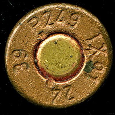

Sorry Pierrejean,in your box is case lot 24. means; P249 IXg1 24 39
Don’t confuse it with a loading lot 7

Nice label, but you are looking at the loading company’s lot number. The headstamp can be derived from the line that reads “Patrh.:S(Stahl)P249.24.L.39”. So, the headstamp of the cartridge cases in your box should be P249 IXg1 24 39 and be copper-washed steel. The IXg1 is the material code which can not be determined from the label (with the exception of some of the early labels).
Sometime during 1943 the case lot numbers were no longer printed on the labels and you have to physically look at the cases to see what lot is in the box and it is not unusual to find more than one lot in a box.
